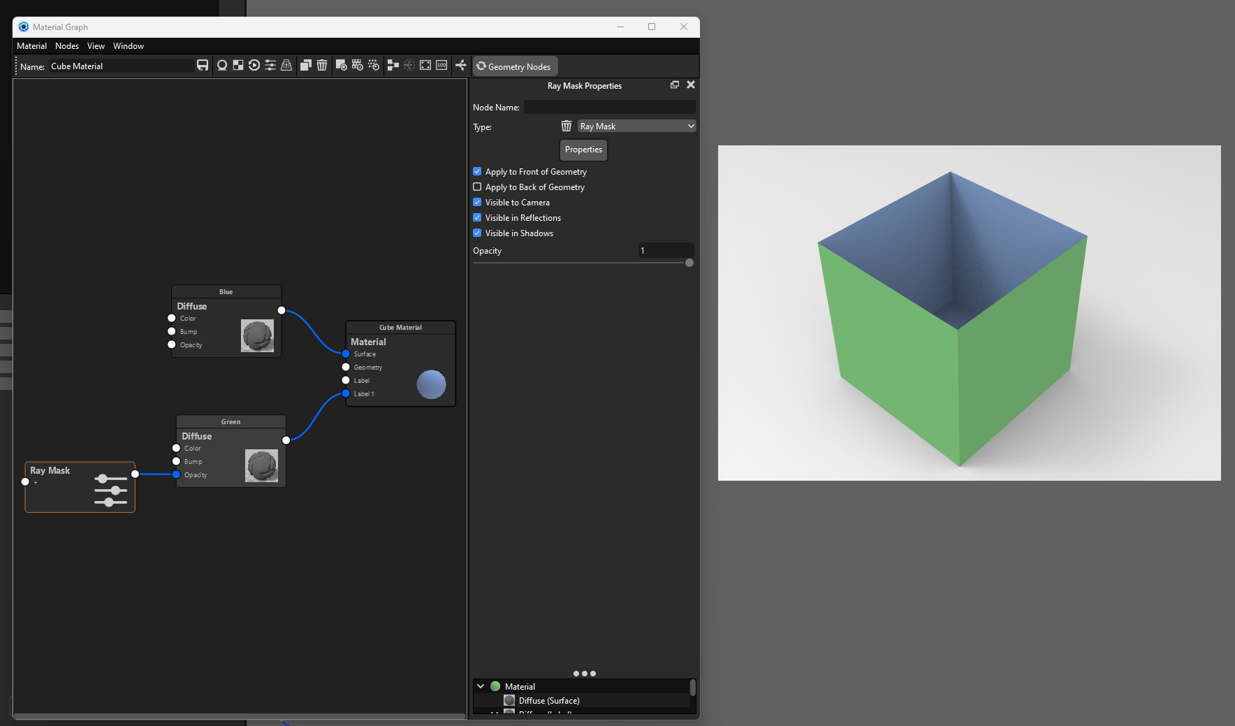

Is that what you want to acheive?
Material A on surface, material B on label and raymask on label opacity with back or front unchecked.
